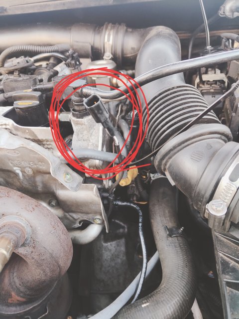

Can anyone help me with this plug please, I purchased a car last week & spotted this plug up on service.
It is a 2 pin male connector plug, Absolutely baffled as to where it goes. I have looked all around & cant see no female connector didn't want to take drastic steps by stripping down unnecessarily.
Thanks in advance

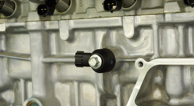

Looks like the "male" end - of a Knock sensor..
To put it back on - looks like you will need to find it's "Mate" - on my car, I have a 1.6L and it uses two - one between the intakes on the cylinder head of Cylinders 1 and 2 - while another is bolted by the intakes on the head by Cylinder 3 and 4 - the 1.6L uses "Bank 0 and Bank 1" and since the Firing order alternates between the 1 3 2 4 similar the "bank 0" one "listens" when 1 or 2 fires - while the Bank 1 - "listens" during 3 and 4 firing - so it "alternates"
But on the Ecoboost - there is only one - nestled in the block...
Considering the location - it can be on the front or back side of the engine - but CLOSE to the length of run that cable reaches, so reference the above and note the connector on the cable has a heat hose on it. So its protected from heat and scuffing - check the rear (Back side towards the firewall) portion by the exhaust side - on the cylinder head itself - must be where this connector goes to - looks like the one similar to above on the block.
IF that (sensor) is missing - then it will need a new one and a bolt to fit it - so it may require a trip to the shop to fix this.
Is it necessary? Yes, if you wish to keep the engine from excessive over timing and spark knock that can damage the motor permanently. The knock is listens for can cause damage from over-advanced or poor fuel - causing pre-detonation which will damage your Ecoboost motor.
